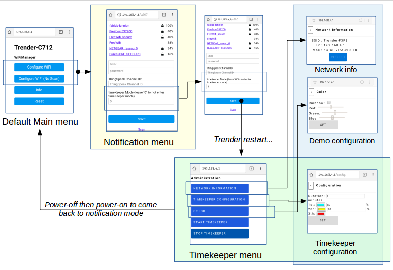

By default the Trender is in Notification mode.
You can switch from Notification to Timekeeper mode by putting 1 in the mode window of the Configure WiFi menu. A green light will blink to indicate that the mode has been changed. The trender will restart and a new page will be displayed on the http://192.168.4.1.
Once in timekeeper mode, you may come back to notification after Trender power restart.

From the WiFi configure menu, once you set 1 in the mode window, come back to the main page. A new menu will be displayed.
You can:
- Cutomize your timekeeper
- Start your timekeeper
- Stop your timekeeper
- Get network info
- Start the Demo mode
Select the menu TIMEKEEPER CONFIGURATION

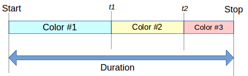

- the duration
- 3 intermediate steps
The duration and different timers can be defined as follows:

The procedure to setup your Trender is:
- From your mobile phone or your computer, select the WiFi network whith SSID starting with TRENDER-
- If the pop-up connection window is not automatically displayed, open a web browser and enter the url http://192.168.4.1
You should see the following screen:
- Configure WiFi
- Configure WiFi (No Scan)
- Info
- Reset
Configure WiFi
The “Configure WiFi” menu allows to connect the Trender to the Web as well as the ThingSpeak channel for the Notification mode. The Trender will connect automatically if it has been already configured and if the network is reachable. It is possible to scan all the access points.
TODO ThingSpeak
The “Configure WiFi (No scan)” menu can be used to configure only the ThingSpeack channel.
Info
This menu provides Trender physical information (Chip ID, IP Address, MAC, …).
Reset
This menu can be used to perform a factory reset. Be careful! All the previous parameters (especially the WiFi configuration) will be cleaned.
